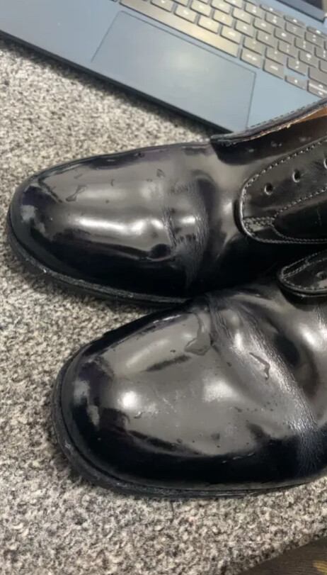

hii! im working towards a promotion, infact i have a CPL interview soon. im polishing my shoes but they just dont shine as much? (female shoes btw) ive mainly been focusing on the toecap too. ive just been circling layers of polish on till its shiny but like is there anything else i need to do? ive had my shoes for 1.5 yrs now but theyre just not as shiny as they used to be
If they have been polished for years, maybe remove the old layers and start again. Are you able to upload pics so we have an idea what they look like?
What polish and process are you using?

Personally, I brush polish with a cream polish to nourish the leather (something people often neglect if they keep layering wax polish on top of other layers), particularly around areas that are scuffed, cracked, damaged, or otherwise not shining so well.
Then I use a lint-free cloth (Selvyt, in my case, but it doesn’t have to be) that I have soaked with water and wrung out, with Saphir polish, using small amounts of polish at a time, ‘bulling’ in a circular motion, until the polish and water disappear into the leather.
For special occasions, I then top-up that bull with Saphir Mirror Gloss (using the same technique).
theyre still wet since ive js finished another layer, i use the normal kiwi shoe polish and i js wet a cotton ball, put polish on it then rub it around the shoe, let it dry for 5 mins or till i get impatient then i rub another clean cotton ball on it till its shiny
oh yeah and they look way shinier when theyre recently polished & wet but if i let them dry, tmrw they’ wont be as shiny?
If you leave them to dry, you’ll get watermarks. Keep going until the water is either dried by the warmth from your fingers / friction or worked into the leather. Alternatively, you can use a bit less water to start with (whereas I wring my cloth, you could squeeze your cotton ball).
P.S. They look better than I was expecting from your description, but you’re right to pursue high standards.
