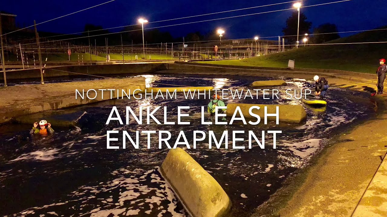

I do wonder if, even using quick release leashes, whether they would have made any difference. Unless you’ve done a WWSR course you’ve probably never tried to release one under load whilst being dragged under the water. If the first time you are doing it is being recirculated in a weir I struggle to see how you would succeed.
Infinitely more hope than you ever have with an ankle leash:
It’s also not even just about the release, it’s where the tug from the leash is pulling you, if your leg is being pulled to the surface, your head is being pulled down, at least if the leash is connected to your waist your legs are free to try and kick.
