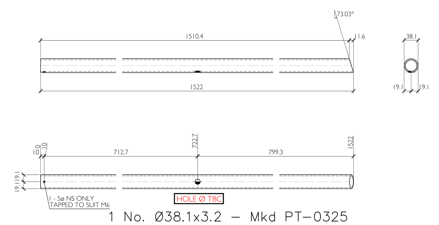

My work GPT project is working brilliantly, though. I have a script which I point to a folder. It opens all the PDFs in that folder and looks for the longest dimension, the part name, and the quantity. The drawings look like this:
The screenshot is just the middle, they contain loads of other info around it, but can’t share that.

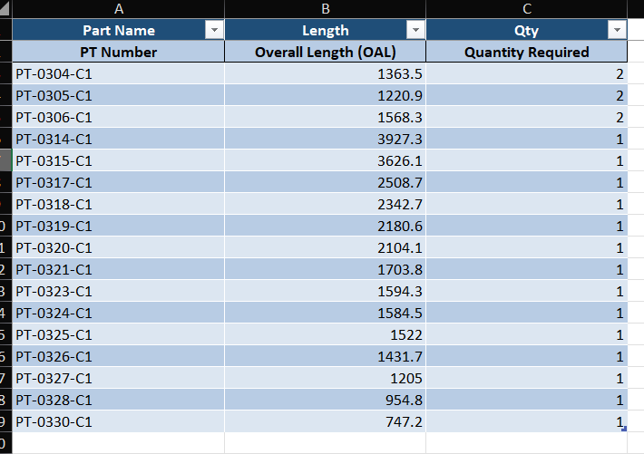

It goes through all of them and spits out a lits of parts, lengths and quantities. This:

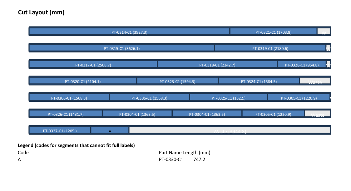

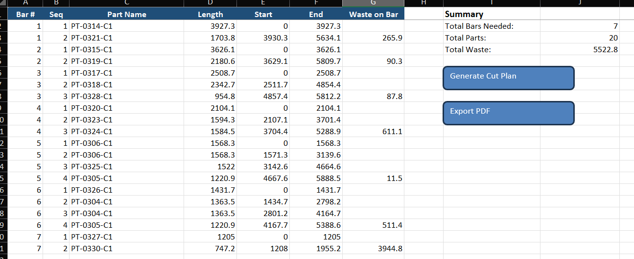

I then have that sheet automatically apply a bin packing algorithm based on stock bar length to work out the number of bars to buy, and where to cut them. It also creates a PDF for this.
This has taken only a few hours to create. It handles different drawing types, as no drawings are ever the same layout. It has a settings page for things like stock bar lengths, kerf etc.
It has produced a metric butt load of python and VBA code. I’ve fixed a couple of minor bugs. But all in, bloody impressive for a few hours work.
And all this processing is now done locally too, so not actually uploading the drawings anywhere.
