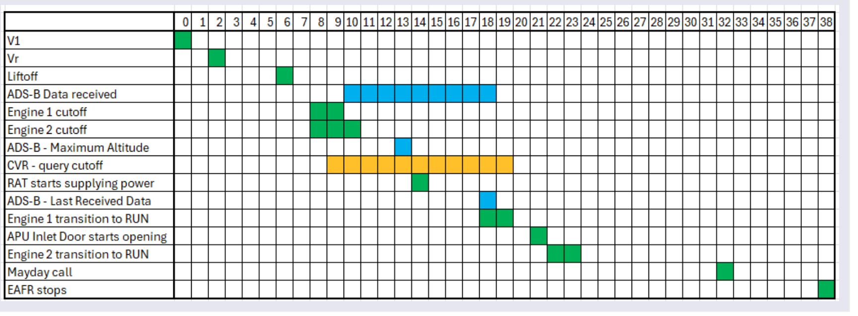

So the switches were both found in the normal run position. And records show they were switched off 1 second apart. One pilot questioned the other why they had done that, then shortly after they were switched back to the run position. But with not enough time to get back up to speed.

    Engines shut down (fuel cutoff switches moved from RUN to CUTOFF) immediately after takeoff at ~180 KIAS.
One pilot asked, “why did you cutoff,” other replied “I didn’t.”
Both engines restarted midair but insufficient time for full recovery.

  1. Flight Data Recorder (EAFR):
    Forward EAFR data recovered, showing both fuel cutoff switches moved within 1 second.
Thrust levers were forward (takeoff power) until impact.
Audio confirms confusion in the cockpit during engine shutdown.
EAFR showed engine relight attempts but only partial recovery achieved.

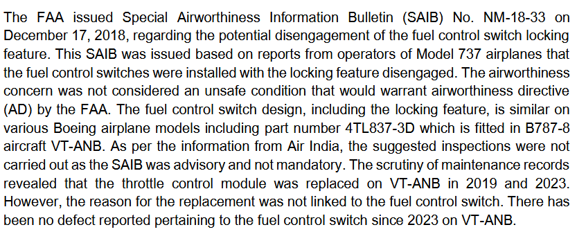

  1. Maintenance and Airworthiness:
    Recent minor technical issue (“STAB POS XDCR”) was addressed pre-flight.
Several MEL items were active but within valid limits.
A 2018 FAA bulletin warned of possible fuel control switch disengagement—Air India did not inspect switches since the advisory wasn’t mandatory.

That control module had been replaced twice on that aircraft, too.

With regard to the physical timings of events / operation of switches, someone on another forum has suggested that the date sampling from which the timeline is being calculated could be + / - one sec.
As he mentioned, it will be essential to analyse the full spectrum of the cockpit voice recorder to try to assess when / if the cut-off switches were physically moved. Note the important point that the data frame does NOT monitor the physical switch position:
The data frame is recording the state of the fuel control switch system, being OFF or RUN. It does not monitor the physical position of the switch itself. It is normally reasonable to infer that the state has followed the switch but at the risk of sounding like a broken record, electrical systems on aircraft are prone to issues with water ingress, and we have learnt that computer systems are also prone to bit flipping from cosmic radiation. I doubt that this is anything like Kev’s big day out at Learmonth, with QF072, but I also remain concerned over the potential for deluge of pooled water into the E&E bay, which has happened before. The evidence to put that to bed will be a spectral analysis of the time from liftoff onwards, looking for the signature of a switch being repositioned to OFF and then back to RUN. The Fuel Control Switches have an audible snap in most cases when repositioned. I would also spend a lot of time looking at the engine start case to detect the switch being positively locked into the RUN position.
When reading any of the data when it comes out, pay some attention to the sampling rate of the data being provided, it is quite possible to make erroneous assumptions where that is not taken into consideration. The data buses used to get data from the aircraft system to the recorder, and the recorders themselves use sequential sentences, and various rates.

As mentioned previously, the data sampling / recording does not record the physical cut-off switch position.
If the transcript from the cockpit voice recorder AND associated actions (“not me”) = accurate, then is there the possibility (however faint) of technical failure?
Boeing fuel switches safe, regulator says after Air India crash Air India Crash: Aviation authority says fuel switches are safe
Unfortunately I don’t remember where I saw this but I did read that there had been an issue with the switches generally before, and that Air India had not carried out any remedial actions.
If that’s true, then my theory is that the pilot/co-pilot was manually checking whether the switches were located in the correct position assuming that they may have moved themselves during the take-off.
The BBC link above seems to indicate no safety issue.
“Although the fuel control switch design, including the locking feature, is similar on various Boeing airplane models, the FAA does not consider this issue to be an unsafe condition that would warrant an Airworthiness Directive on any Boeing airplane models, including the Model 787,” said the authority, in an internal note shared with the BBC."

The timeline from elsewhere ( + / - one sec as outlined earlier) covers what happened & when.
i have seen this too.
the actions were issued as “advisory” and not “mandatory” and so Air India did not act upon them as there was no requirement to do so
not the source i first saw it, but does back up the above: https://www.ndtv.com/india-news/was-advisory-not-mandatory-air-india-on-us-report-on-fuel-control-switch-8864970
